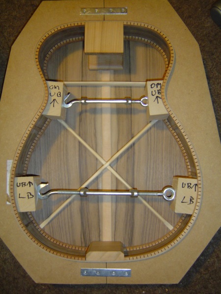

I've used MDF for my moulds ever since I started building guitars, the same ones in fact. So far my OM mould (the one in the picture above) has been home to 10 guitars. My moulds have all surfaces sealed with boat varnish, and are still as good as the day they were made. with screws being put in and out at least a couple of times during each instrument, If the screw hole wear (they haven't) just move the screws.
As far as weight is concerned, they are a bit heavier, so what? It's good excercise, we don't do enough of that.
colin
